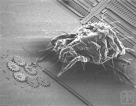

A mite, less than 1 mm in size, approaching a microscale gear chain. (Image: Sandia National Laboratories)​
