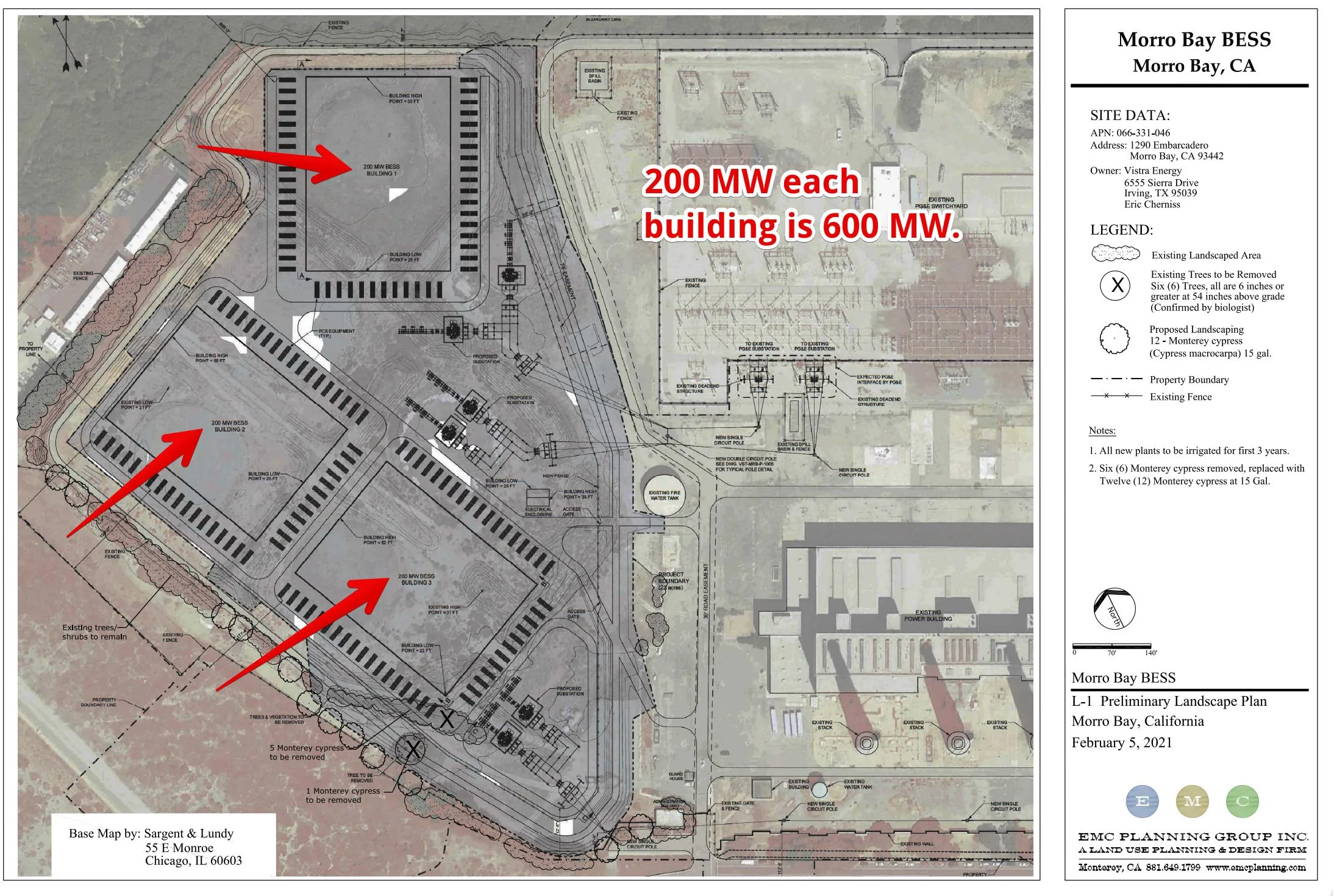

Morro Bay could become home to the largest electric battery system in the world if a project being proposed by the owners of the Morro Bay Power Plant is built, bringing a windfall of tax monies to a city left financially reeling due to the coronavirus pandemic response and near shutdown of the tourism economy.
Representatives from Vistra Energy made a presentation to the City Council Jan. 26, proposed a massive, 22-acre complex with three, 40-foot tall buildings, each some 91,000 square feet.

The company’s presentation said the project would have 2,400MWh of capacity in 180,000 lithium-ion batteries. The batteries are grouped into “racks” and enclosed inside the buildings, each with its own room. The three buildings being proposed total 273,000 s.f. Again as a comparison, the parking lot at Spencer’s is about 170,000 s.f.

Not a viable project either from what I can tell.
$120,000,000 of batteries for $4.8m return is ROI in 25years? Only possible with subsidies.
