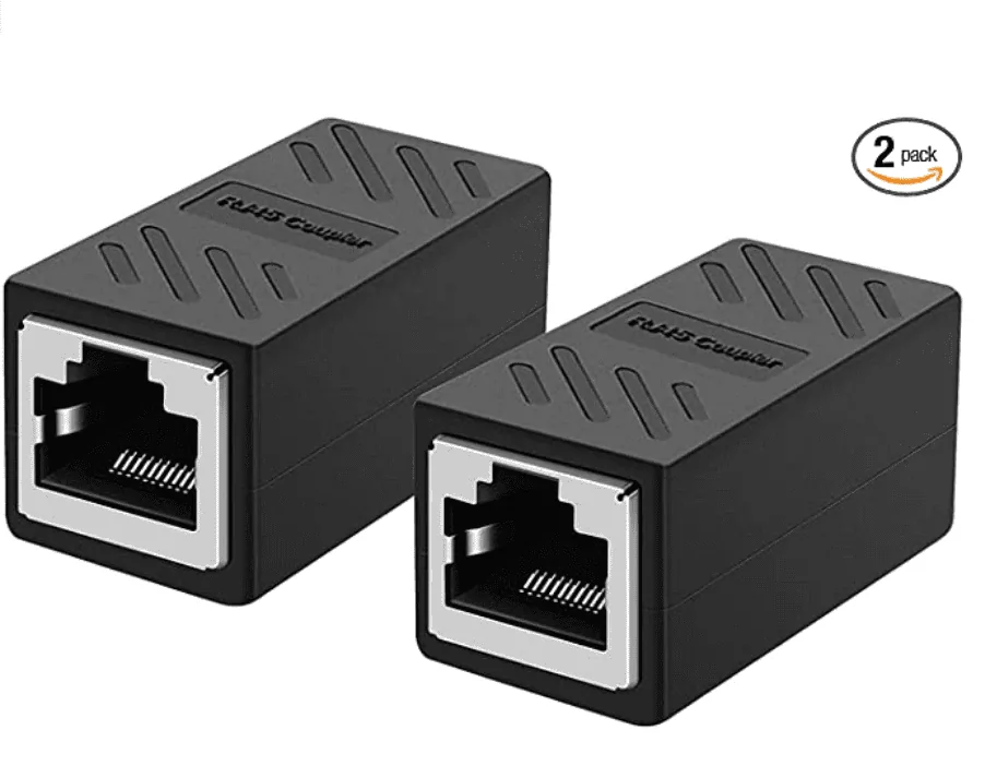

What cable do you use? I mean is it bare copper or CCA (Copper Clad Aluminum)?
I had many issues with CCA cable if it runs more than 100ft. POE security cameras are really sensitive to resistance and often do not start if the voltage is a bit lower than it needs.
solution is really simple and cheap. It always saves my day, instead re-run line we just added this small device on the camera side and vualya!
RJ45 Coupler
2027 Ram Dakota Pickup Any network geniuses in the forum to answer a question? 1640414141897
(Picture is taken from amazon)
That is why when you add POE injector to the line even without powering it from the grid your AP started working. It has a microscheme inside that works as voltage rectifier.

I have a mixture of a few different brands of wiring but most of the longer runs are good quality copper that my electrician uses in new residential construction. They are mostly from leftover boxes of wire from finished houses that I’ve saved and made into lengths I need. I like doing this because the cables end up being the exact length needed. I do have a few pigtails here and there that might be CCA but I’ll have to check. If I do they would just be short pieces I have acquired over the years that come boxed with various items. I will track these down and replace just to alleviate that possibility too. And yes the switch at the working location is the exact same brand and model as all of them. I have tried several other switches too but still no bueno. Also, in the picture above are those just simple couplers or are they some type of special voltage conditioners?
Deleted member 5322
...... Also, in the picture above are those just simple couplers or are they some type of special voltage conditioners?
They are just simple couplers, I usually keep for "just in case". I bought them from this seller:
( Amazon.com: DEFACE RJ45 Coupler Cable Coupler Cat8 Cat7 Cat6 Cat5e Female to Female Ethernet Adapter 10pcs per Pack Black : Electronics )
I would recommend using a nice CAT6 tester. Klein Tools VDV501-851- this is one of the cheapest testers that can show if you have "SPLIT" because I think your power pair might be split as well. (in this case, Cat6 data plug has a garbage quality - cut the old ones and make new ones on both ends). Coupler should help in this case as well.
We used Fluke network testers, but they cost more than $1.2k. With this guy, you will see exactly what makes all troubles.
