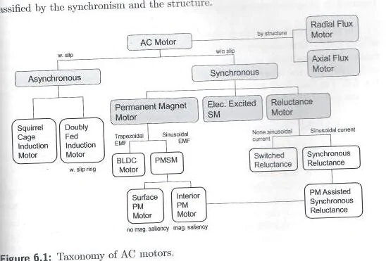

ajdelange
Perhaps this will help you with the terminology. It's been posted before.
Clearly the motor Munro did a video on was interior type with the nabla (or maybe V) configuration (IIRC). Various motors have been used in EV, even, I think, a pure switched reluctance one. And manufacturers and researchers are always trying new things hence the article cited in the OP and the CRIM (if that's what it really is) that Musk has been crowing about.
Tesla Model 2 How ‘switched reluctance motors’ are being brought back, mainly to advance electric mobility  Motors
Please note the interconnecting line between PMASR and IPMM on the diagram. I don't think it is always possible to put a motor in one class or another.
Bill906
Yes, that does agree with my theories. Thanks. So would you agree that it is incorrect to call the Model 3/Y motor a PM SWITCHED reluctance motor and that it, given the information we have on it, is actually a PM Synchronous Reluctance motor?
ajdelange
I'd say it is potentially incorrect to describe it in any terms other than those used in the manual but as whatever it is it develops some reluctance torque I wouldn't be too concerned as long as it wasn't called an induction motor.
